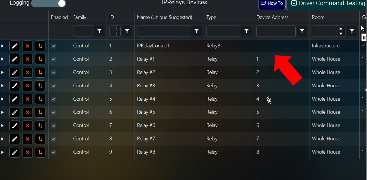

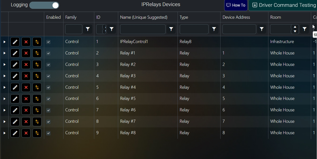

The relay controller can be accessed and controlled using a browser by typing in 192.168.10.25/30000.
I did find this in the iMatic documentation."Note:  the "Port" is not really a port number at all.  It is just a custom URL path.  So, the device is always on Port 80 and cannot be changed if you need to Port Forward your firewall for some reason.
I tried IPRelays|AddController~IPRelayController1~192.68.10.25~30000~8~Infrastructure.
The resulting screen looks like the attached - blank device address..  I have tried manually configuring the address 192.168.10.25/30000 or 192.168.10.25:30000 or 192.168.10.25:80 or  http://192.168.10.25:80.  Can't find something that makes MyServer happy.

Still can't get this to work.   So exactly what is supposed to go in the device address?  And what format?
Thanks Chris
