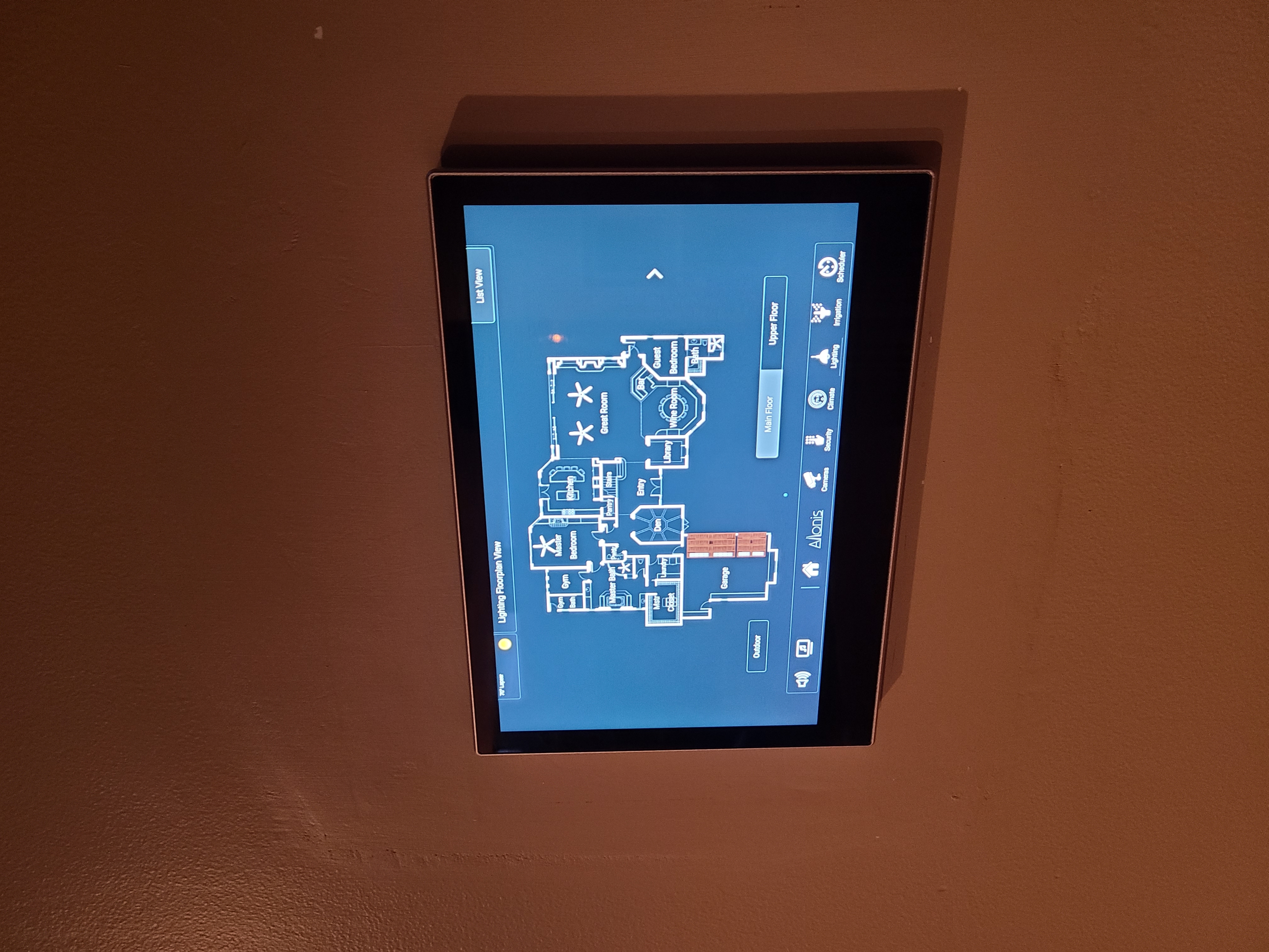

Allonis's new SmartScreens are inexpensive, yet high performance Android On Wall tablets.  They are perfect for using either the Phone Template (for portrait screens) or the Tablet Templates (for landscape screens).
SmartScreen55 1
They are very easy to install and configure.  The included mount is perfect for Europe or US standard single gang back boxes.  They can be powered via POE ethernet (recommended if you have that cable in the wall), or 12 volt DC and you can use ethernet or Wifi.
Because you can use Wifi and 12 volt DC, they are perfect to add to your RV or Trailer or Truck / Auto.  Boats are also a possibility, but note the screen is not sealed against moisture.

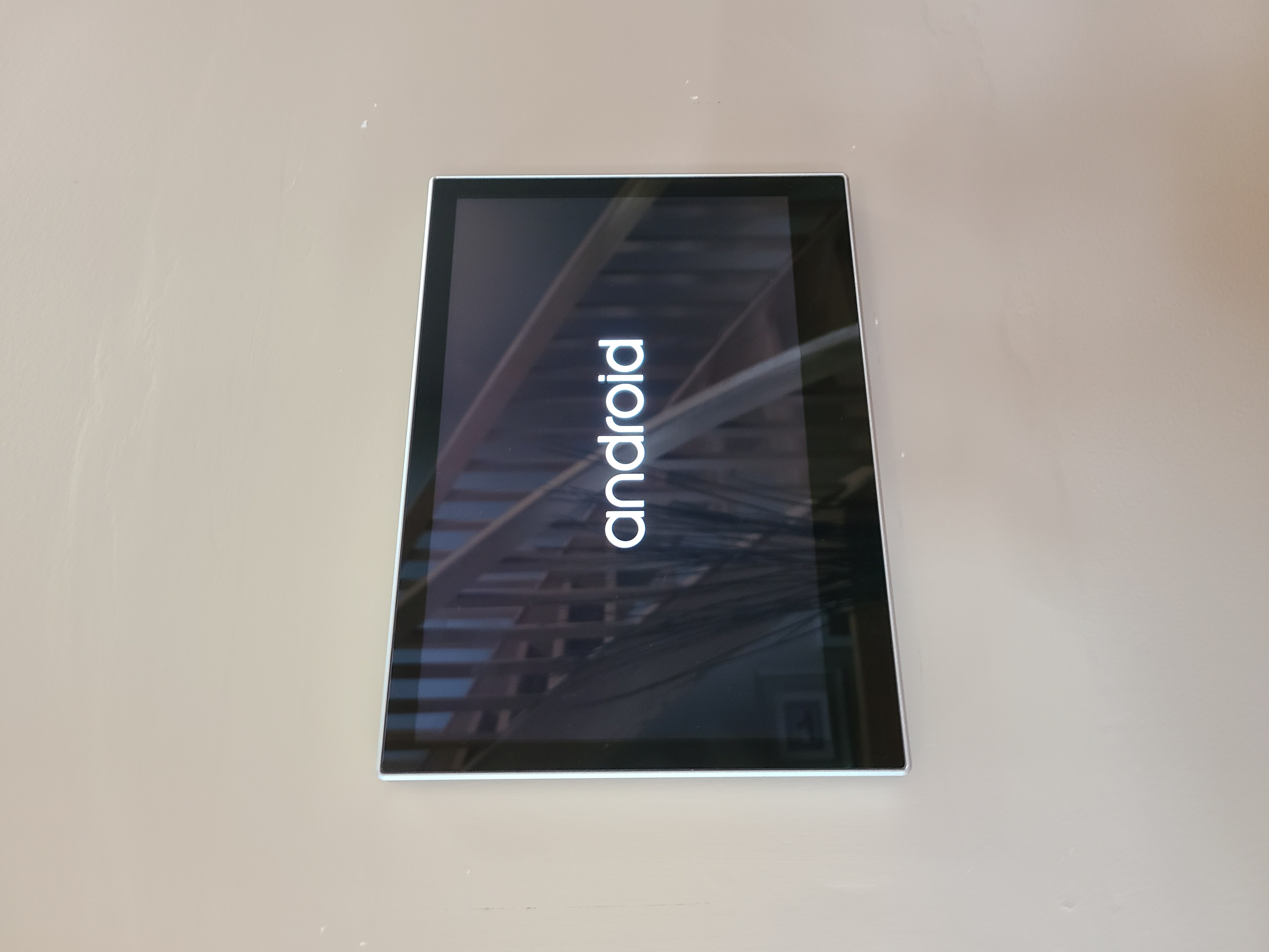

You will see the Android logo followed by the Android Desktop.  Click on Settings and configure your network (either Wifi or Ethernet (recommended)).

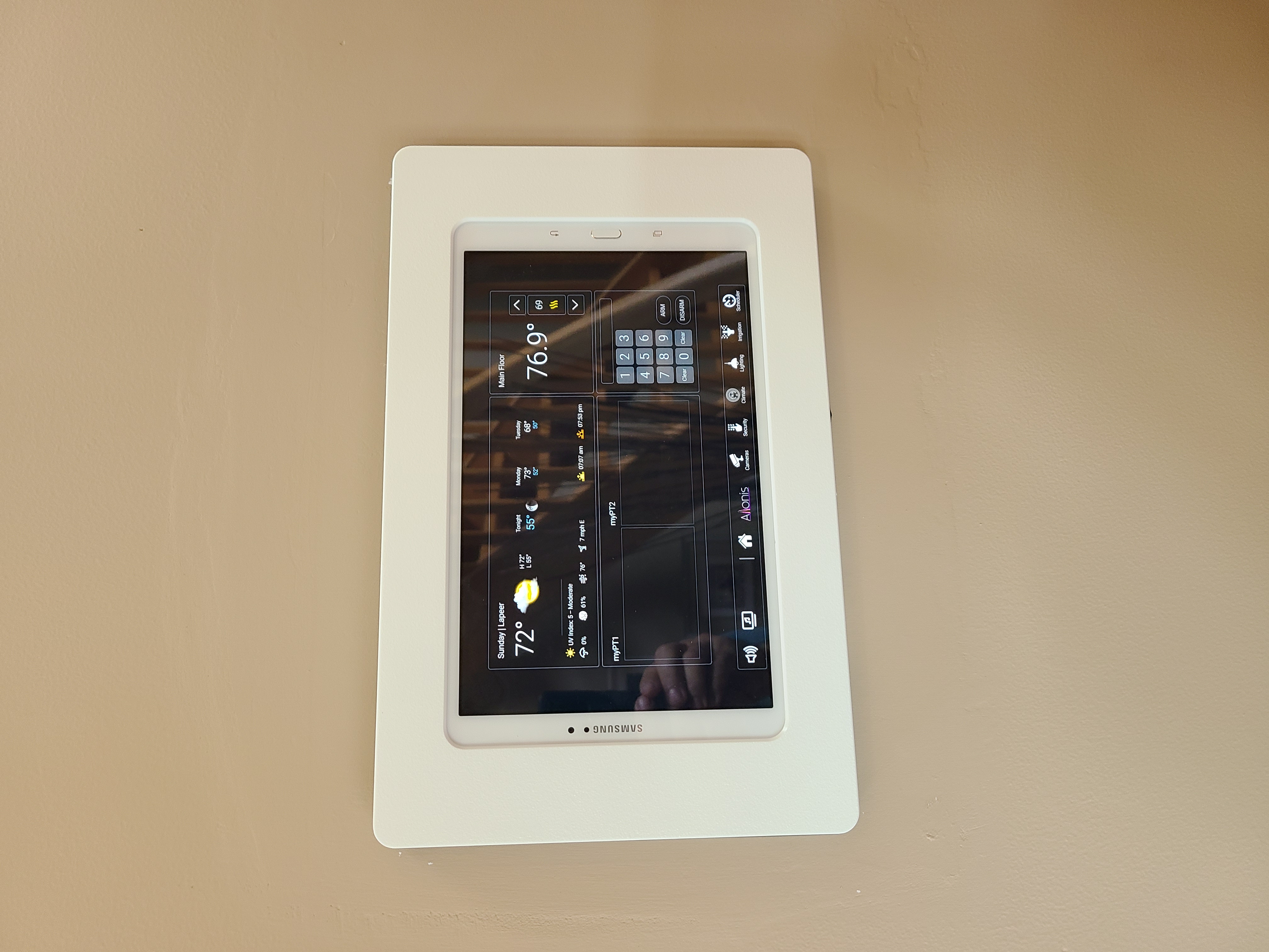

We had an old Galaxy Tablet in a surface mount.  It was getting a bit slow so we wanted to upgrade to the Allonis SmartScreen 10.
Here is how we did it.
Picture of the old Galaxy

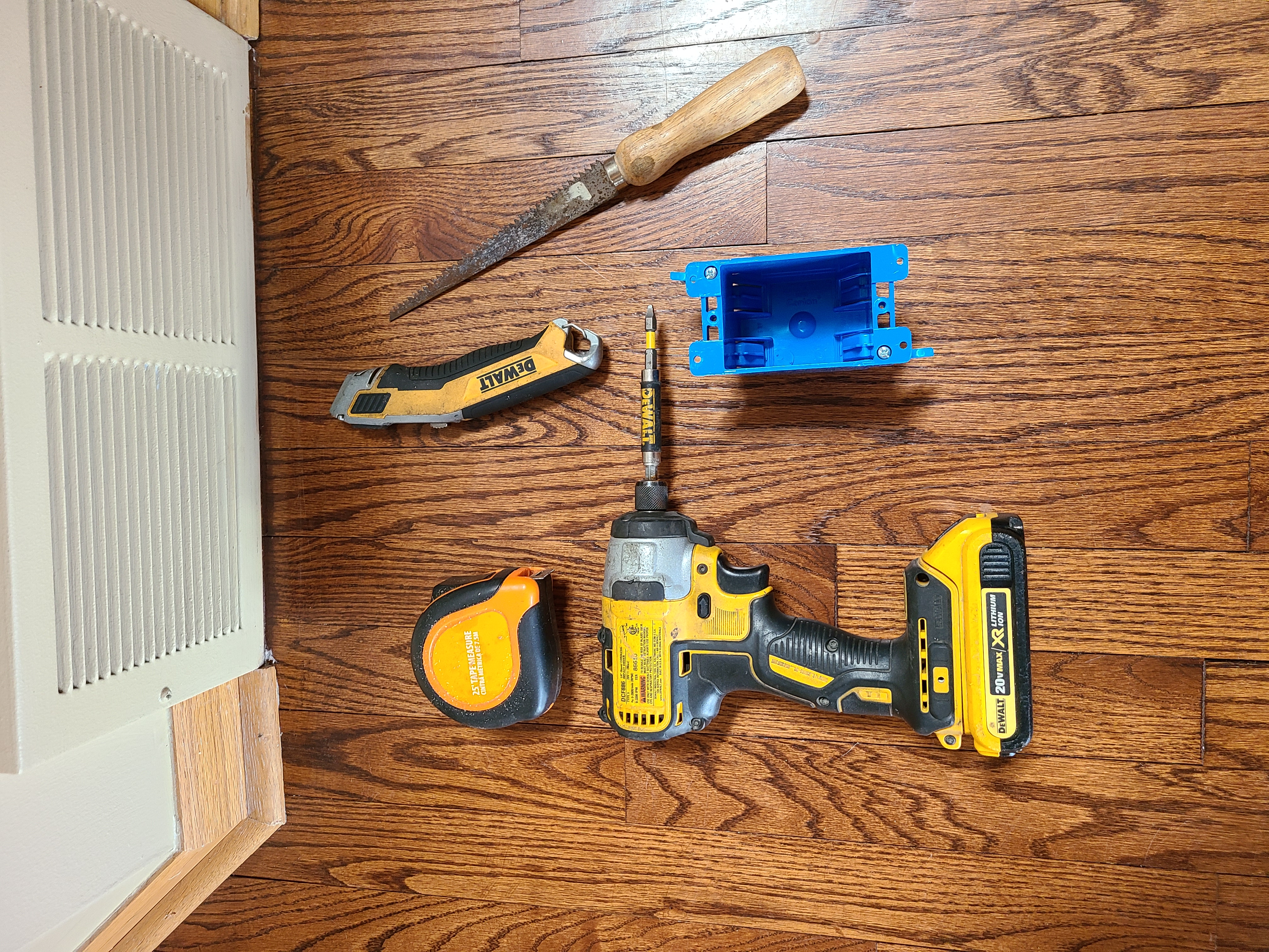

 Tools Used
20230910 154245

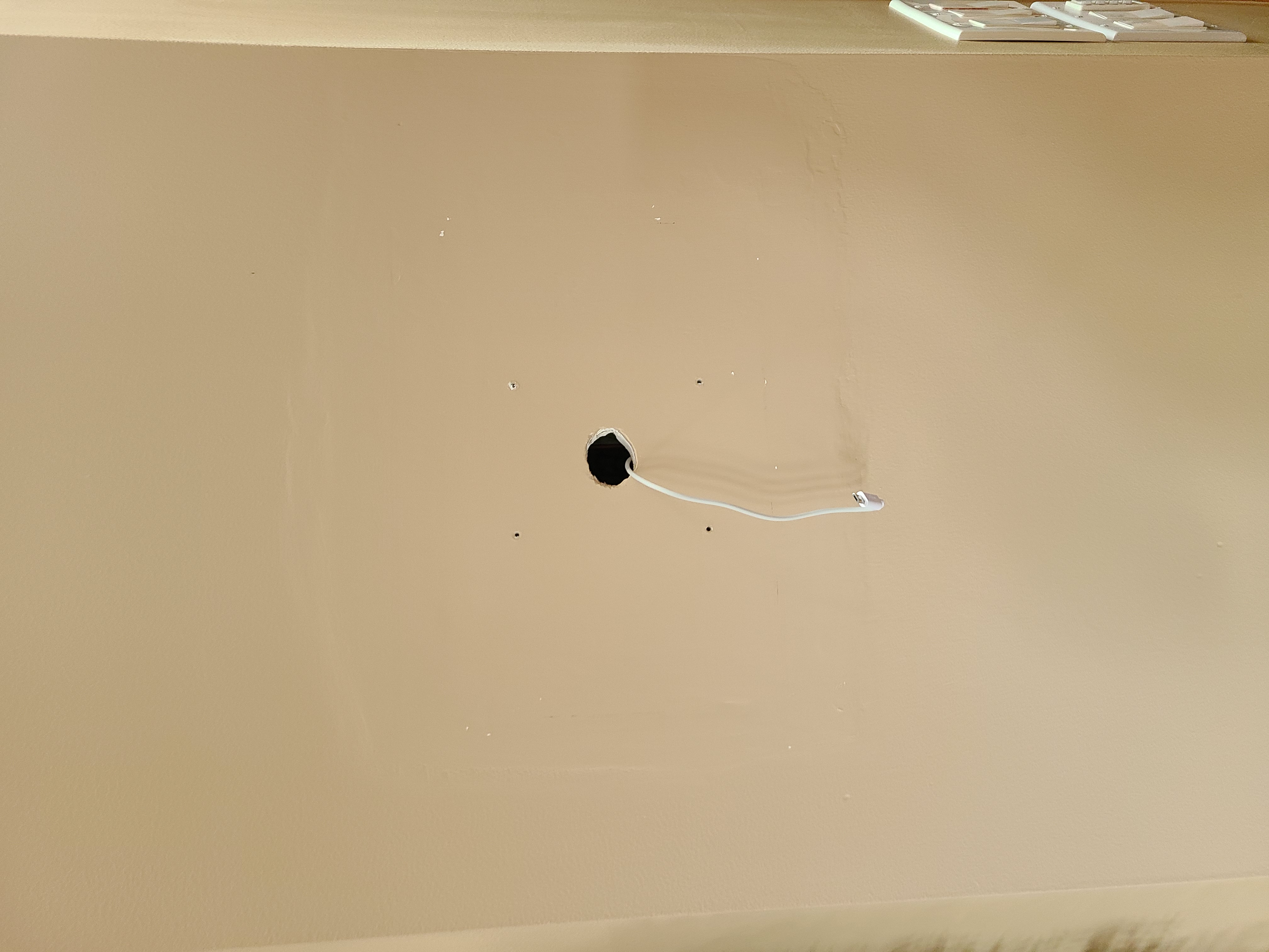

Tablet Removed
20230910 153717
Ready to Install New Mount
20230910 154339

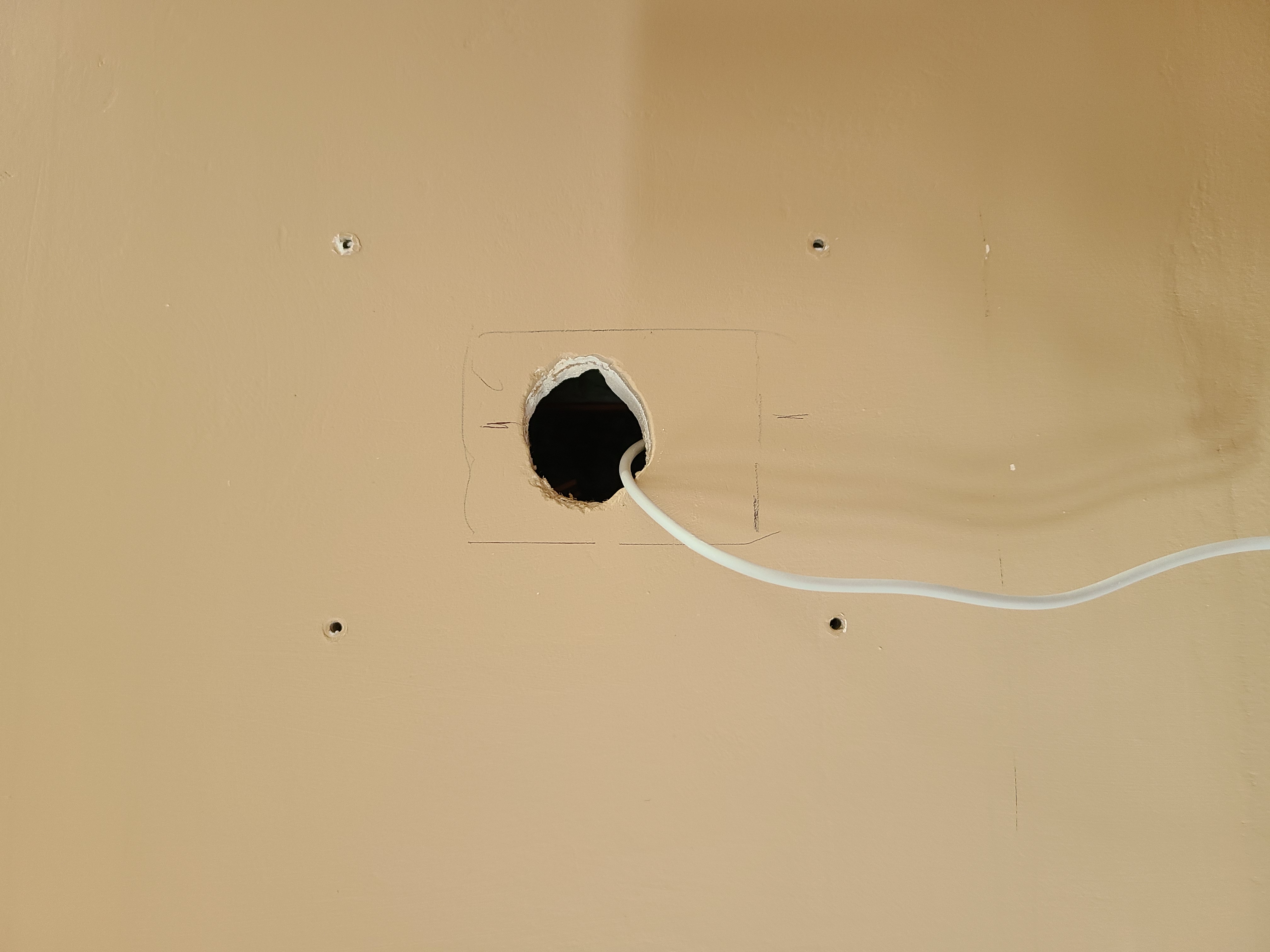

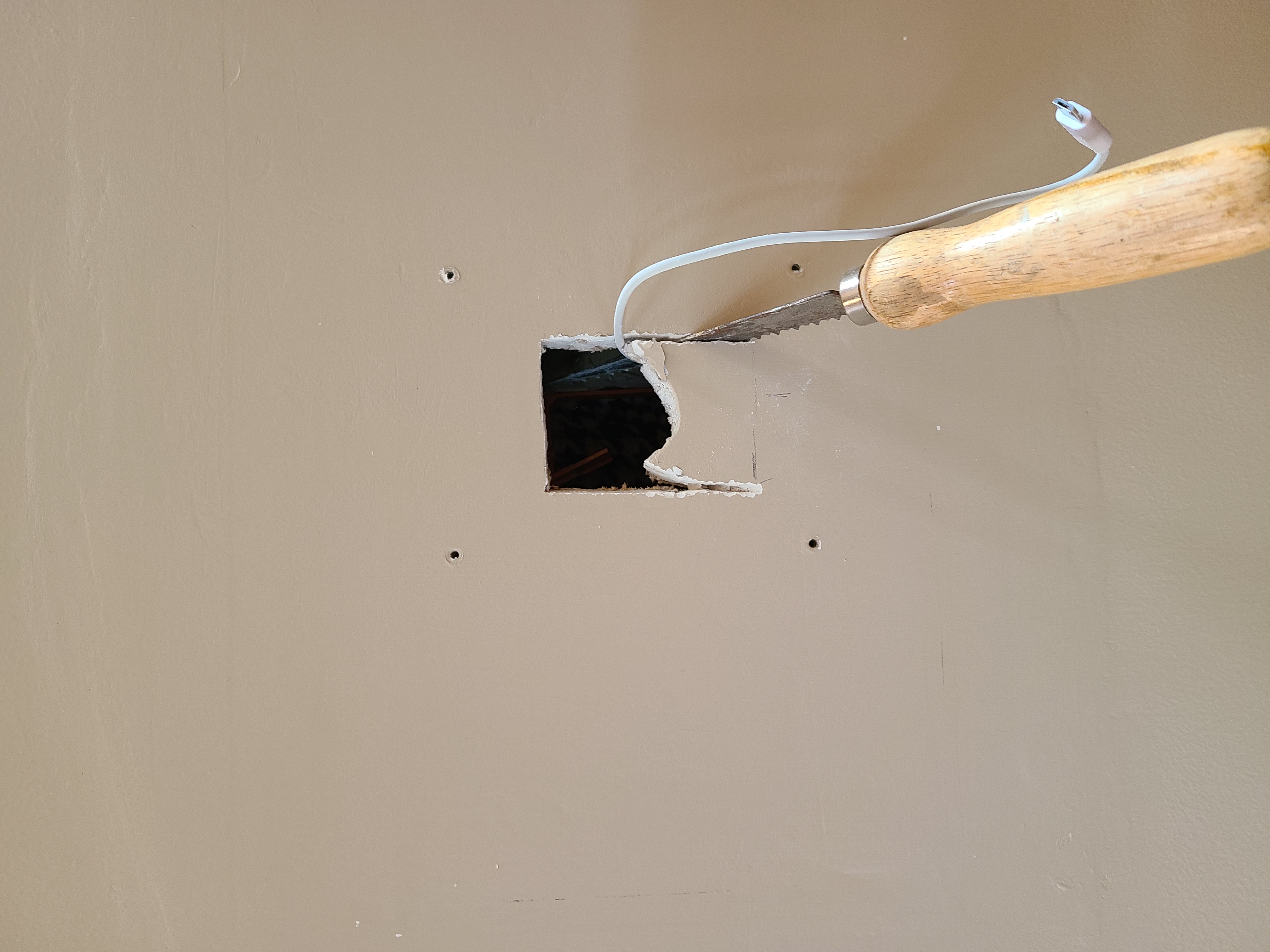

Put "New Work" electrical box against wall in the center location you want the screen, and mark where to cut the hole
20230910 154501
Make your cuts with a Drywall Saw
20230910 154701

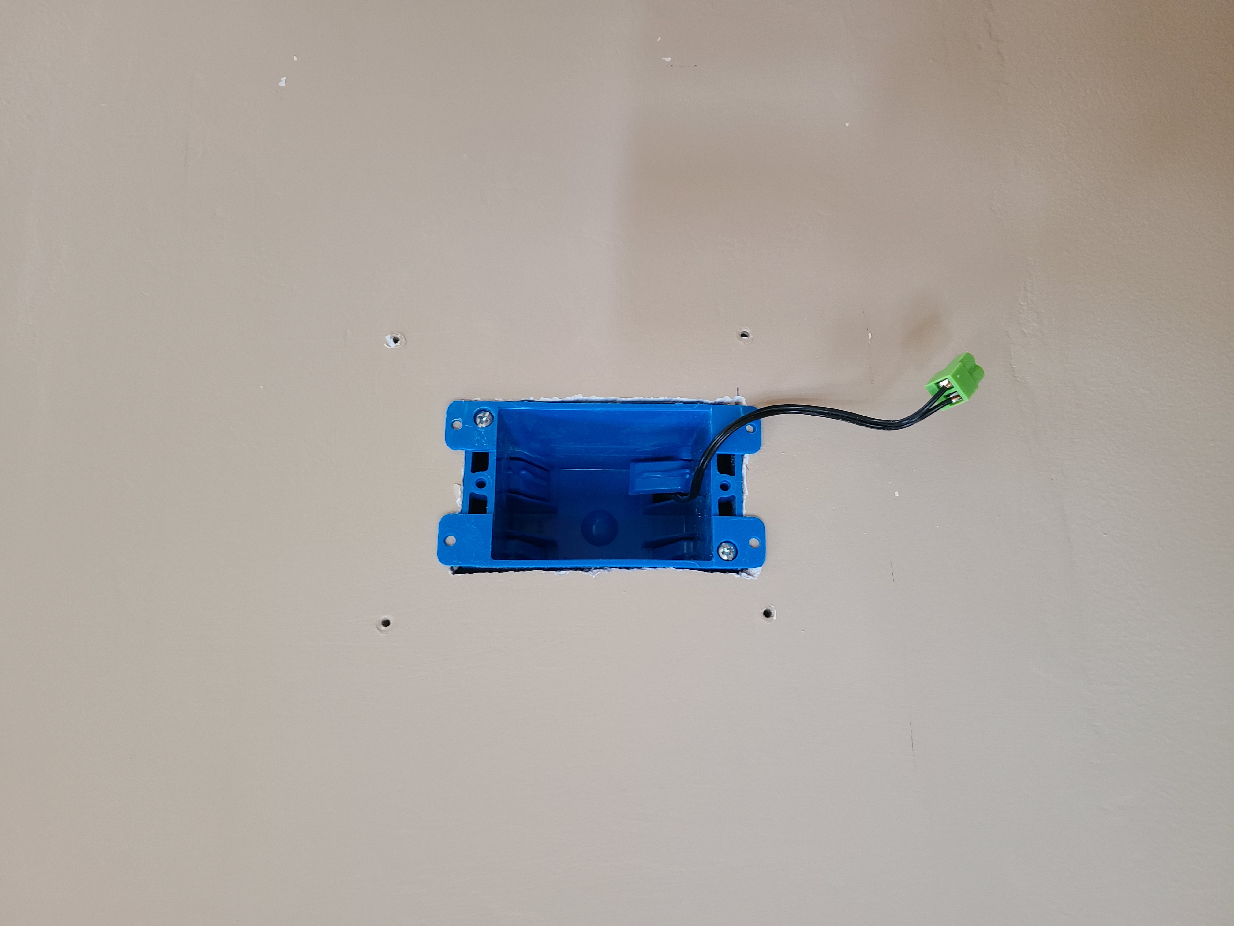

Install your new wire (we will be using 12 Volts from a wall power supply on the opposite wall.  Best is to use a POE ethernet cable to both power and supply data).
Install the "New Work" box into the hole.  Tighten the wing screws to draw it tightly to the drywall and hold it in place.

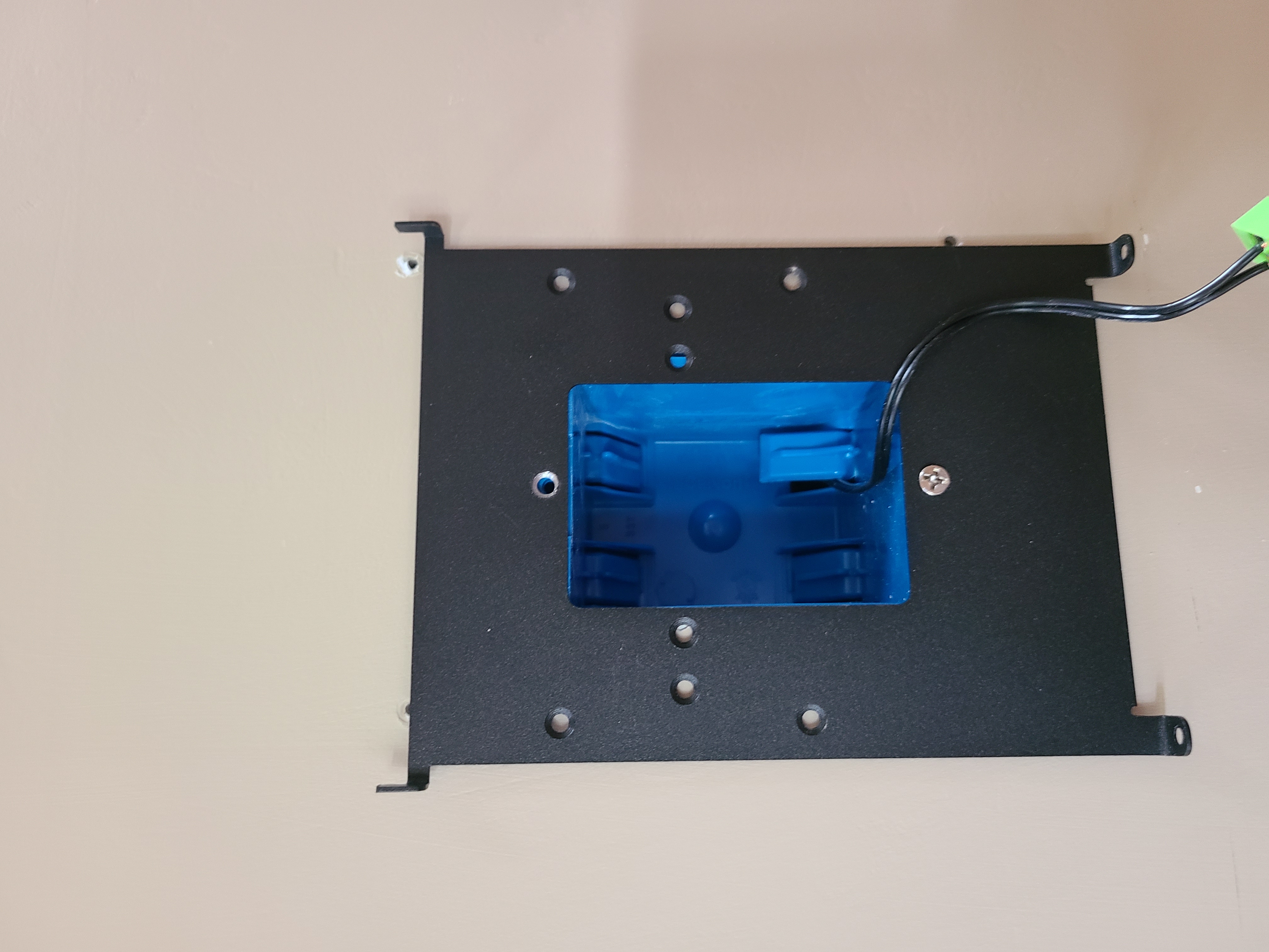

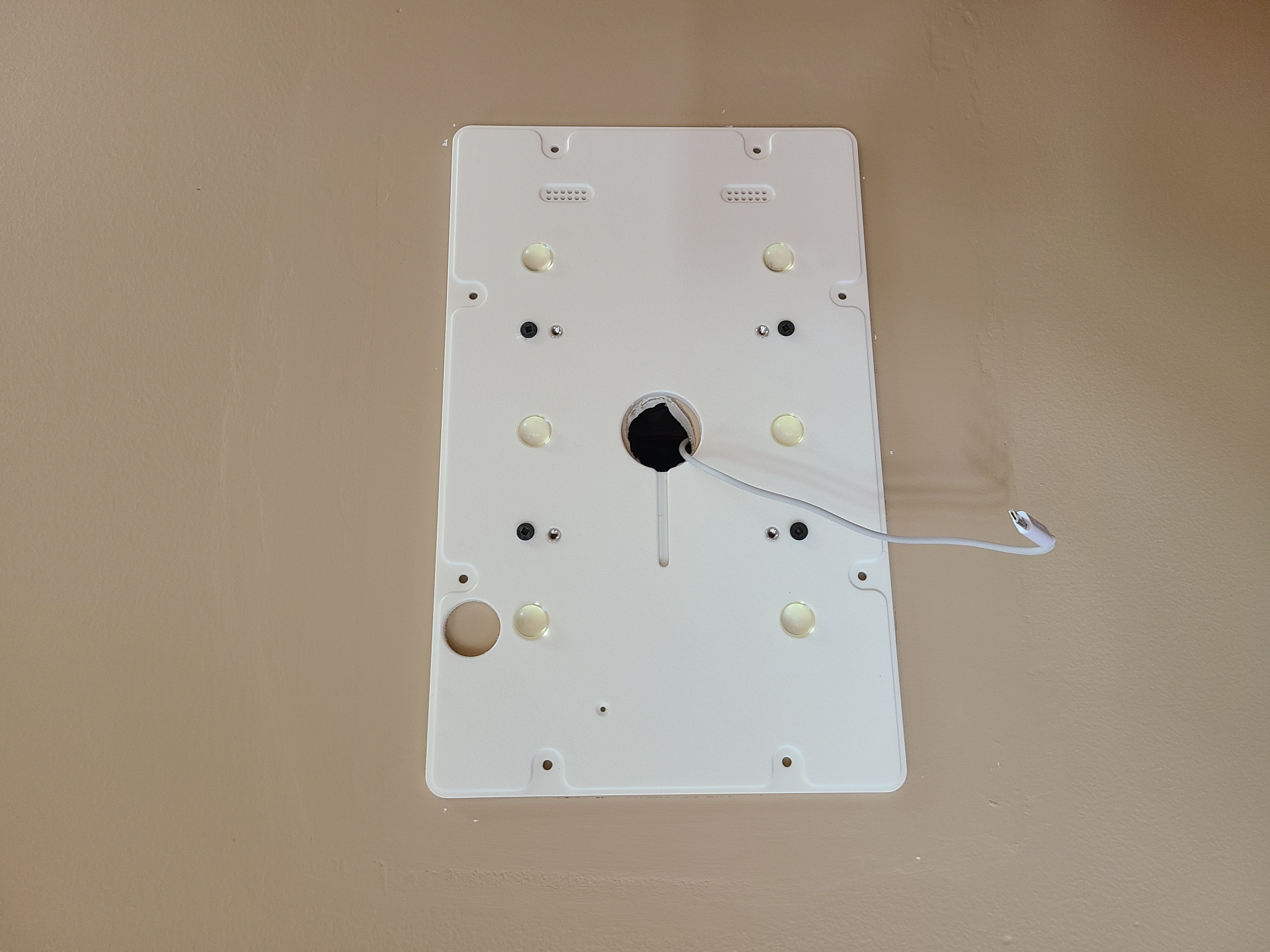

Install the two screws to hold the Mount to the New Work box.  Note:  we drilled two new holes to position it Landscape.  Future mounts will include these drilled holed.
20230910 163238

Insert the top wings into the slots in the back of the touchscreen, swing it down so the bottom tabs grab the outside of the screen and secure with the two tiny phillips head screws to affix it to the mount.
Plug in the power and let it boot.
Once booted, we configured the Wifi Network (since no ethernet cable was available).
20230910 163644
