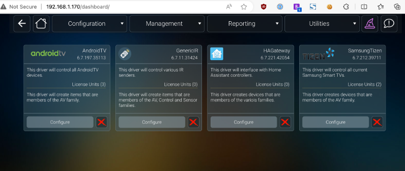

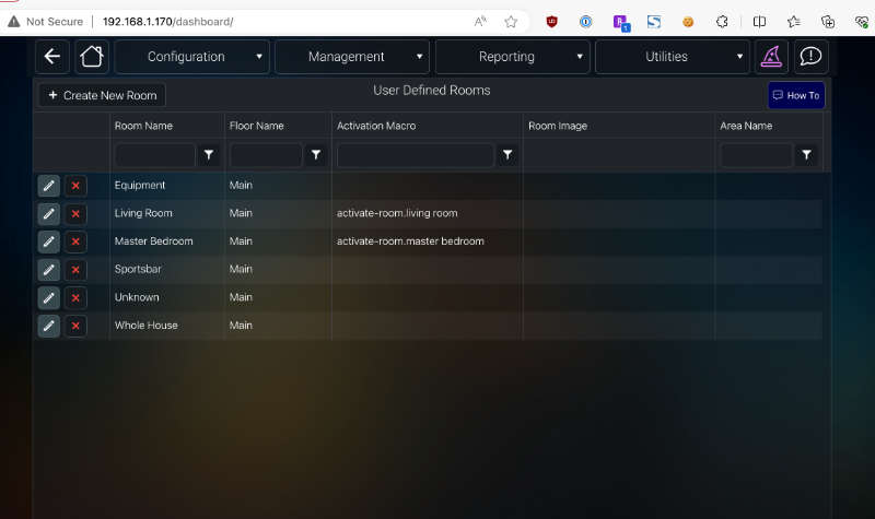

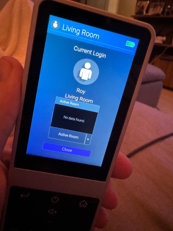

as the title says I added my rooms, added drivers for TV and Android TV Box, however the screen on my smart remote shows the room name and an empty blue background... if I try to change rooms when I tap "Active Room" I get "No data found" instead of the list of rooms (I have 2 rooms I added and a bunch that were already there - can I delete those?)

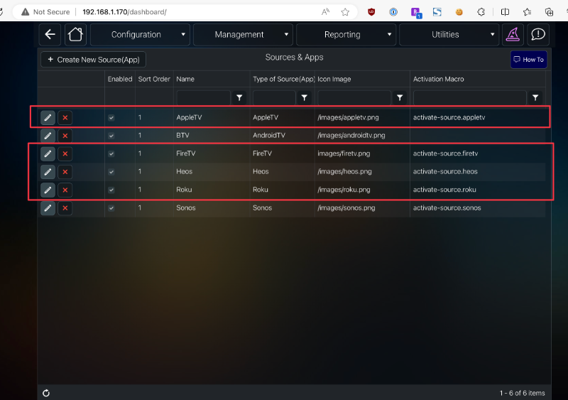

In Source Apps I noticed that after yesterday's update I got a bunch of source apps I dont have drivers (or hardware) for (like Roku, FireTV, AppleTV)... I fear something is amiss?

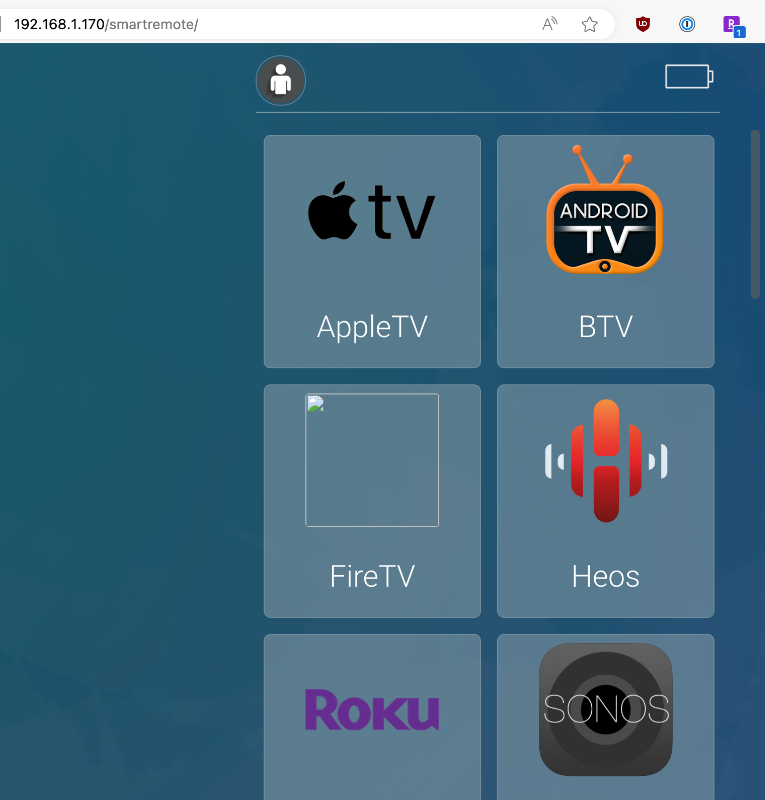

PS: if I click any of the "App icons" on the browser (from my pc) nothing happens, and the screen doesnt change.

Your SmartRemote, if properly networked and the project folder name is same as your browser, should be showing the exact same thing (it is the same thing).
You might want to double check you aren't pointed to a different folder or no folder. And that the SmartRemote is actually on the network and not just displaying cached webpages.

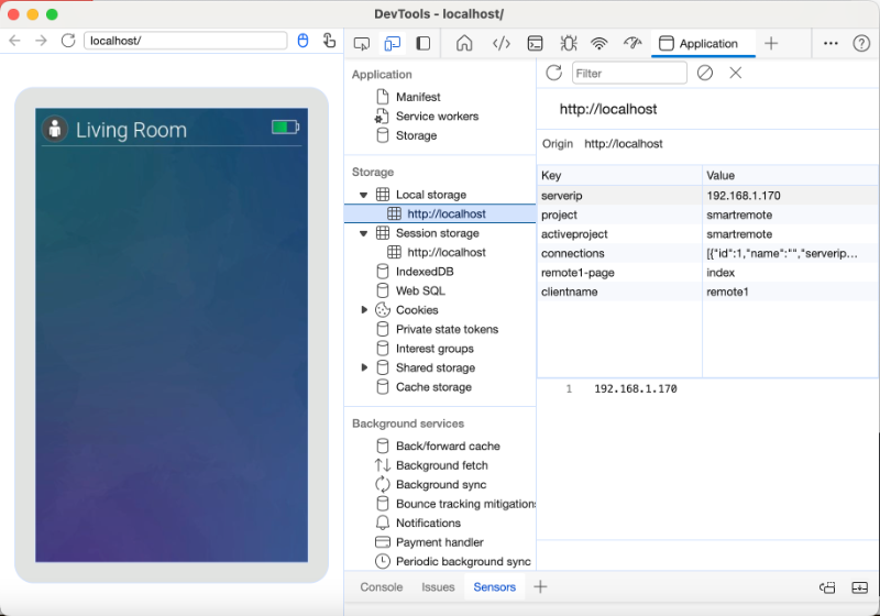

No dice... the network is connected correctly, and I was able to reach it via ADB and check the myServer IP is correct and so is the template name...
Edit: the sources highlighted in red just appeared after the last update...

To Help others:  RoyN missed the step of renaming the downloaded SmartRemote-sample folder and calling it smartremote.  This is the default name for a folder in the SmartRemote settings.  So, the SmartRemote was pointing at a web template folder (the "project") that didn't exist.  Renaming the sample solved that problem.

As you can see on the browser screenshot the path it was opening was indeed "smartremote" and not "smartremote-template". Please clarify?
