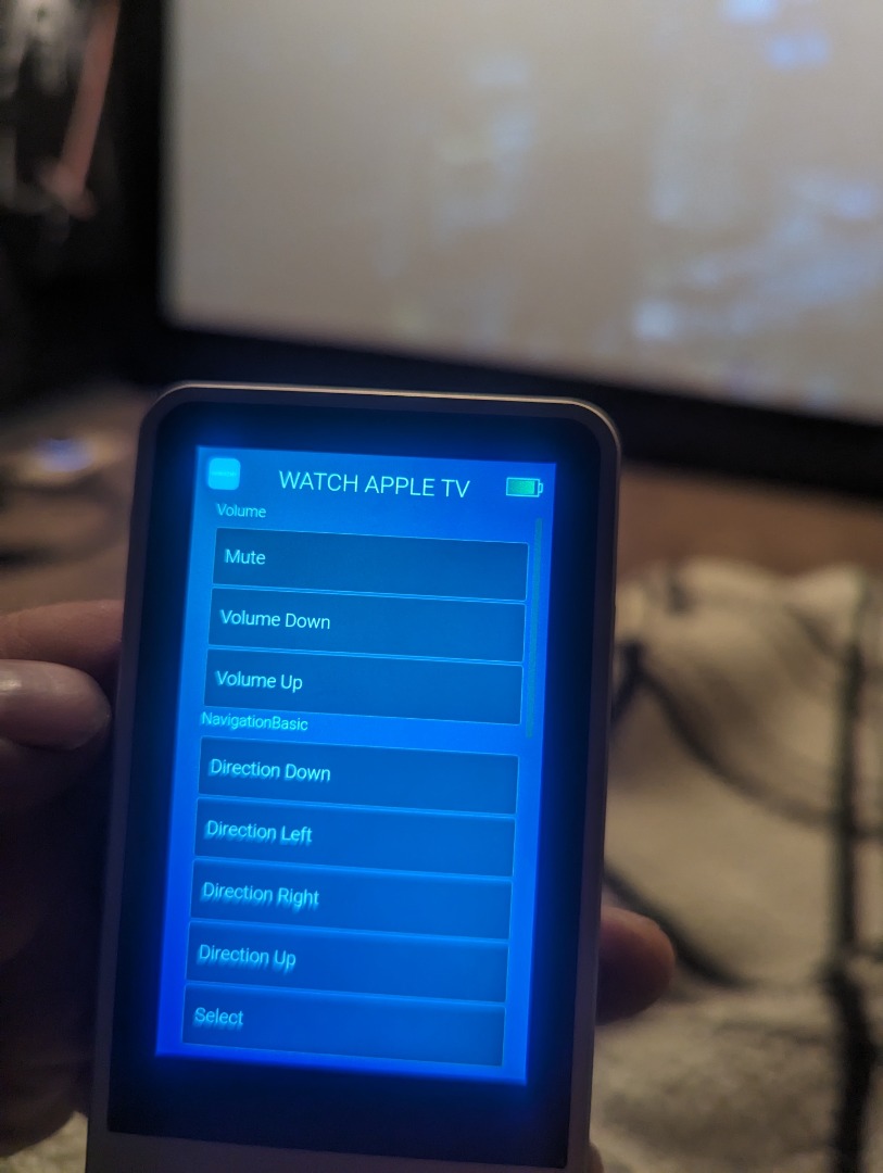

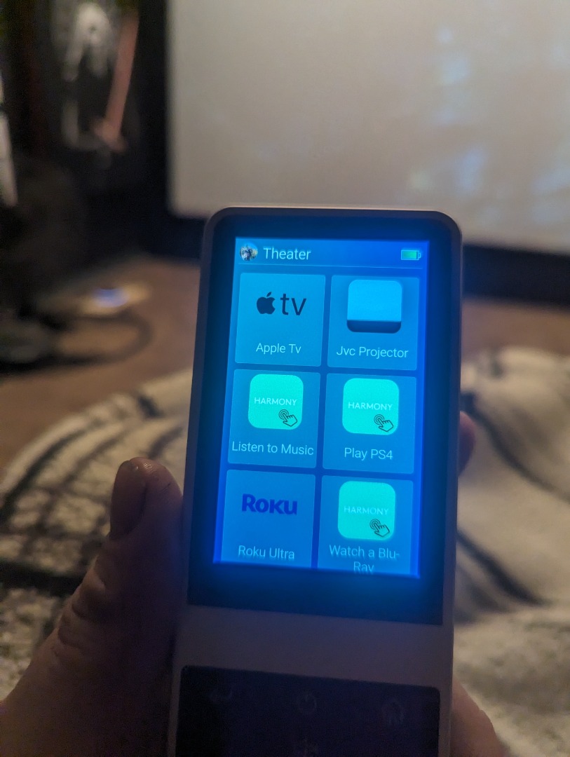

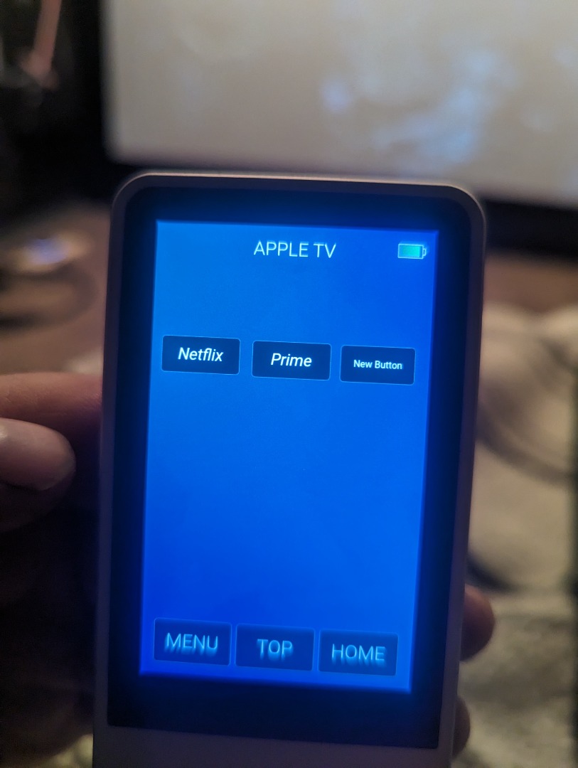

Was any more troubleshooting done on this topic ?
I'm h​​aving a very similar issue with my smartremote. I have the remote connected and displaying buttons and different pages.
I can select different devices and "activities" but no devices ever respond to key/button presses.

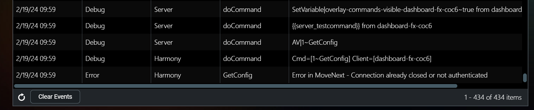

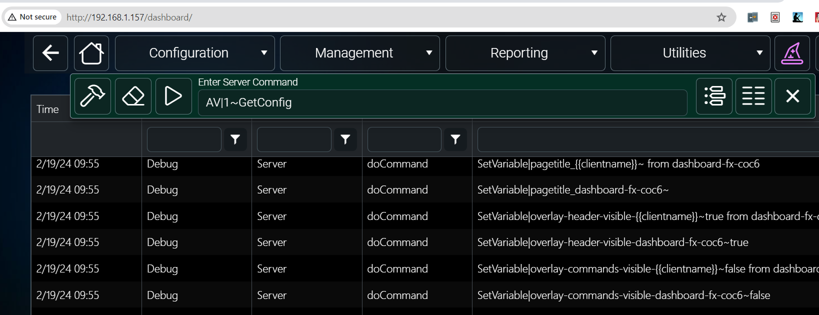

I should have said that you can test for this by using the myServer command builder and running a GetConfig command against your Harmony hub. My Harmony hub has ID 1 in the AV family - yours might be different so you would need to adjust the number as necessary.
AV|1~GetConfig
If the hub has become disconnected you'll get an error in the system events log. As you say, normal remote commands fail silently but the GetConfig command either works or throws an error.
