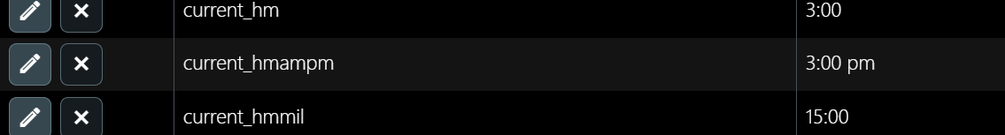

I'm using the Time Widget (copied from a Sample template) and it is frozen on 11:59pm (on both remotes).  Rebooting doesn't fix it and the Server has the correct time.
It's using "{{current_hmampm}}".
This stopped working a few days ago after one of the myServer updates.

Not sure what the problem is here, but could you use a different server variable while you're trying to get to the bottom of this? {{current_time}} should get you to the same time format as {current_hmampm}}.

That server variable exists and its value is correct in my system. I haven't tried the widget though.

current_time bought back the same value.  It appears that my current date and time values (on the server) are stuck at 11:59pm and the date is 01/18/2025 23:59:59

Fixed it.... Once I saw the variables were frozen I rebooted the host and the joy returned.  Restarting the server didn't fix the issue.
