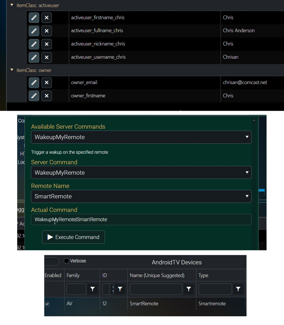

This is interesting David and I am hoping you will have the time to enlighten me and maybe some other folks.  !WakeupMyRemote|{{clientname}}! does not wake up the remote.  I also tried it without the exclamation points.  It will wake up with WakeupMyRemote|Chris.  The remote is named "smartremote," not Chris.   Command builder seems to want the remote name, not the client name.   And speaking of clientname I can't find that variable in MyServer.  But if it's there it does not seem to have a value of Chris.   I did see a variable "harmony_active_device_chris" with a value of 1,
I'm puzzled and would really like to be able to wrap my head around all this.
Thx, Chris
