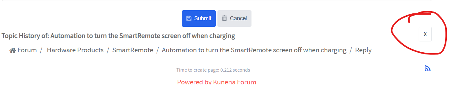

It turns out it does let you see the thread but it's very well disguised. Along to the right of the submit and cancel buttons when you're creating a reply is an 'X' in a box. Clicking on that reveals the thread. Why an 'X' when that usually means 'close'? Who knows.

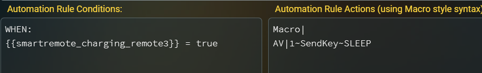

Hmmmm,
I cannot get this to work.  I can send a command via AndroidTV to the device (I just turned off the power).  The device is named remote0  and it's ID is 14
The two commands are like this:
{{smartremote_charging_<remote0>}} = true
Macro|
AV|14~SendKey~SLEEP!
It seems the conditions are never met...so nothing in the log.

Should you be having <> around "remote0"?

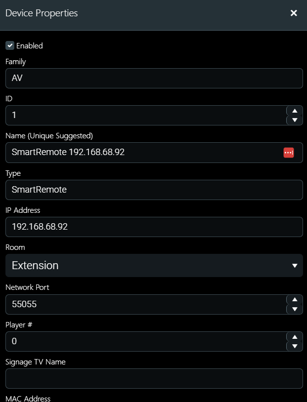

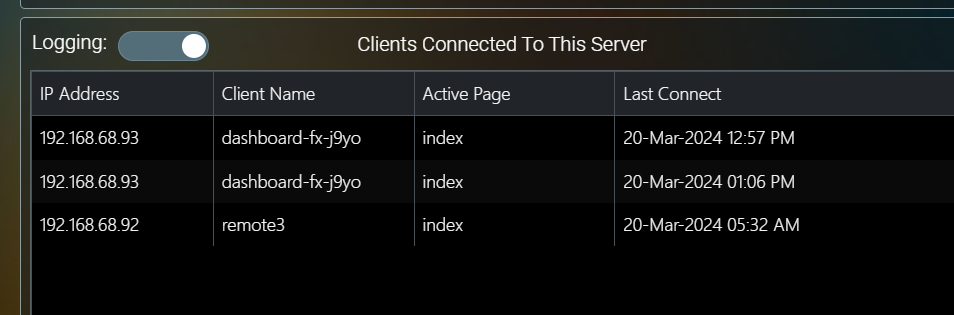

Attached are screenshots showing how it is setup for me and it works (obv different ids and name for the remote) -
I got rid of the final '!' if that makes a difference - doesn't the '!' separate two separate commands - but it is not required here as there is no command which follows it.
Have you tried testing it by just sending the command straight from the dashboard (weird wizards hat top right) - also see screenshot attached.
