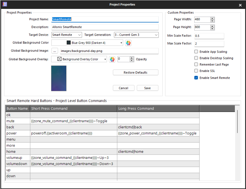

Alright, so I've finally got just about everything in place to get my livingroom setup functional.  I have my TV setup in the driver, my roku setup, and I configured a Generic Serial model for my soundbar and confirmed it works via the test commands.  So now the question is, how do I connect all the dots.  Let's start with an easy example, Volume Up.
In the Generic Serial driver the command I use to command volume up is: "AV|9~Send~PWSoundbar~Volume Up"
In myDesigner the command associated with the volume button is: "{{zone_volume_command_{{clientname}}}}~Up"
In myServer variables, I have the following variables
zone_volume_command_livingroom-fx-posm : AV|1~Up
livingroom_avamp_id : 3
livingroom_display_id : 1
That's kind of where the trail ends for me on connecting things.  First I'm guessing I need to rename my Volume Up command to just "Up".  But where does livingroom_display_id and livingroom_amp_id come from?  Do I have to set those manually in the server variables?  Or is there some config file?
Once I get it understanding to use the soundbar (effectively my AVR), how do I tell it which input is which source?

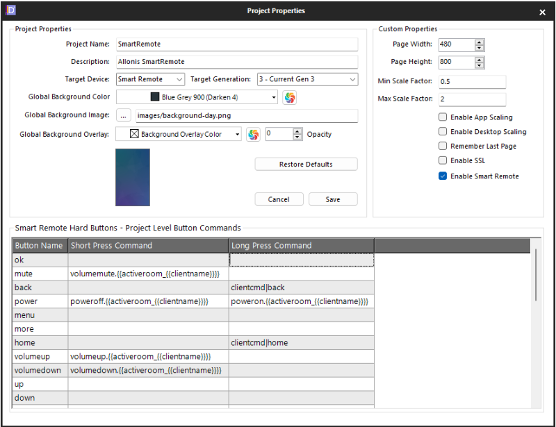

From the designer modify the SmartRemote's project properties. The Properties button on the Projects menu.
Change the global hard button definitions from this
to this
This will tie the default volume, mute and power buttons to the macros that have been created for each room.
Save these changes.
Then go into the individual macros for the rooms and make the edits so they perform the appropriate actions for your room.
Volumeup.LivingRoom macro would become  AV|9~Send~PWSoundbar~Volume Up
and so on.
These changes are in the current SmartRemote-Sample as they will be the default going forward.

Awesome, that works!  Thanks.
