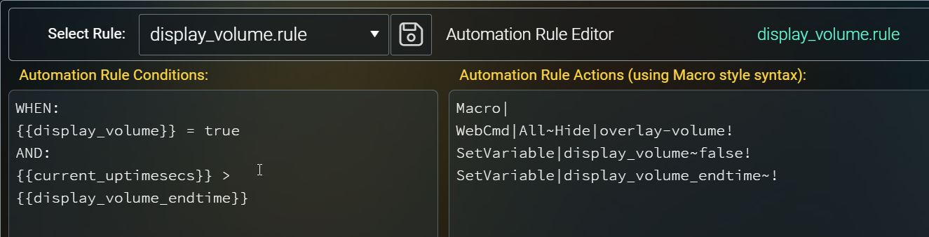

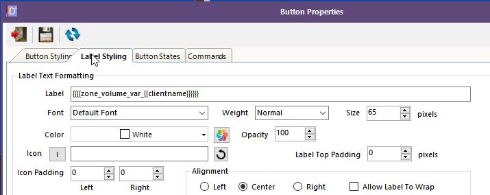

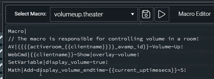

I figured out a way to display a popup with the volume and have it go away after 5 seconds, in case anyone else is interested here is what I did.
I first created an overlay with a button but you could just create a label/button on any scene that's hidden normally and only shows when the display_volume variable is set, the principle is the same.
Then I added some commands to the volumeup/down macros that will show the overlay and set some new variables, display_volume and display_volume_endtime.  The display_volume is set to true and display_volume_endtime is set to the current uptime in seconds plus how ever long you want the popup to stay up, in my case 5 seconds.  Those values will be used in the automation that will be defined next.
And finally I created an automation rule that looks for the display_volume to be set to true and the current uptime in seconds has passed the value we calculated in the macro.  This will then trigger the automation rule which will hide the overlay, set display_volume to false, and clear the display_volume_endtime.
