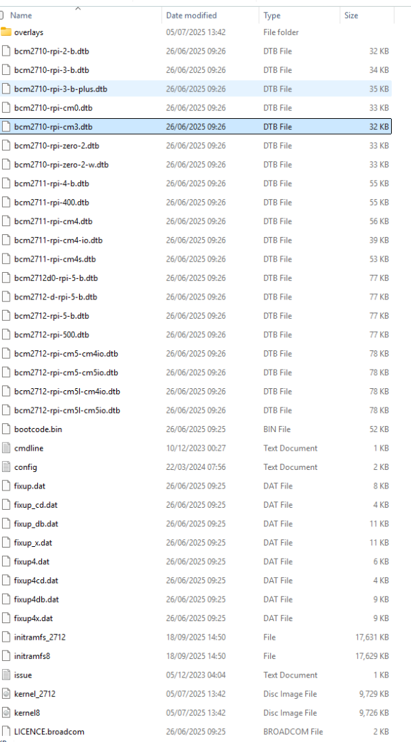

Thanks David. My server is now attached to a UPS. I have connected the SSD from the old server to a windows laptop and this is what is on it. Is there anything there that might let me recover?

Will the old SSD boot the new Pi?
If no, can you boot the new Pi on a new Master image (download today's latest Trixie version) that is burned to a NEW, fast USB drive?
If you then post full boot (like 3 times boot), gracefully shut down, plug in the SSD and reboot...Hopefully that will boot from the new USB and the old myServer files can be migrated from old SSD to the new USB.
Then....apply the New Master image to the Old (or a new) SSD and boot from only that. Then transfer the files from New USB to New SSD. Restart and you have a pristine updated system.
