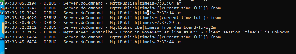

#1670
publishing works great with variables. I am having an issue with subscribing,  When I try to subscribe to anything  I get client session is unknown.
