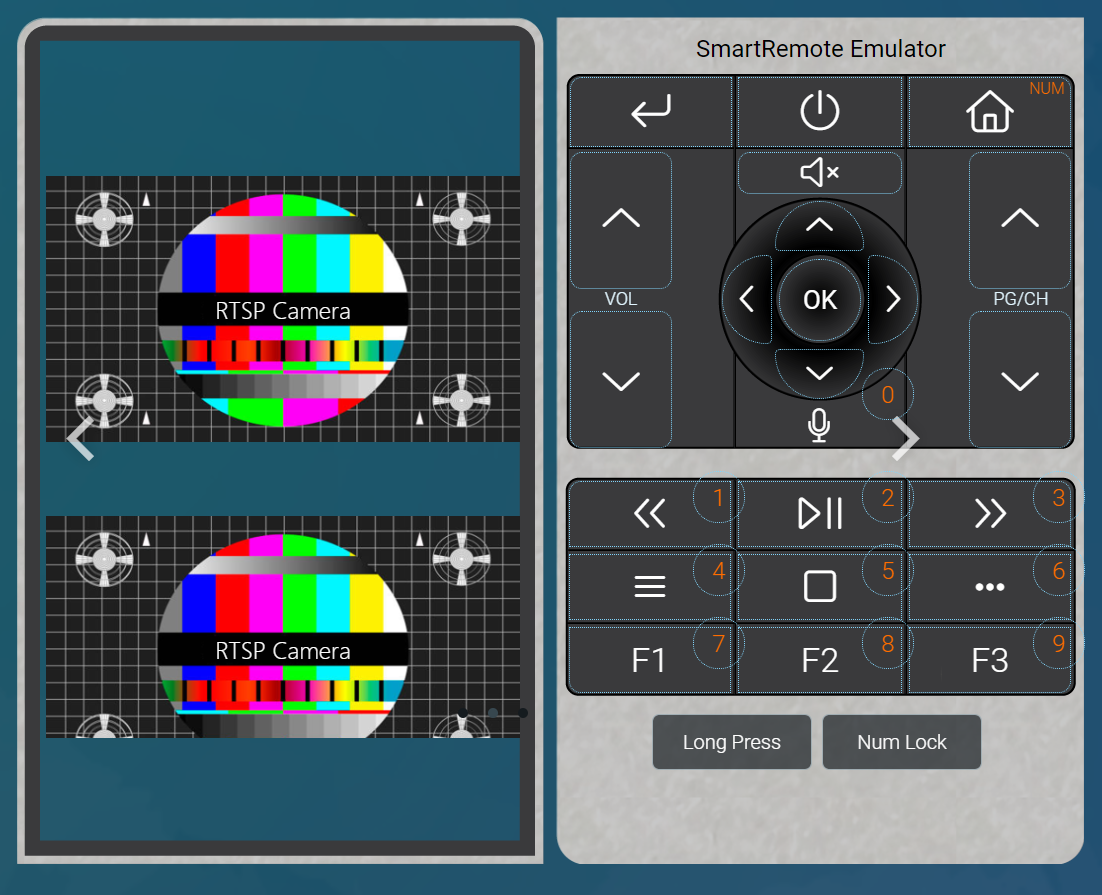

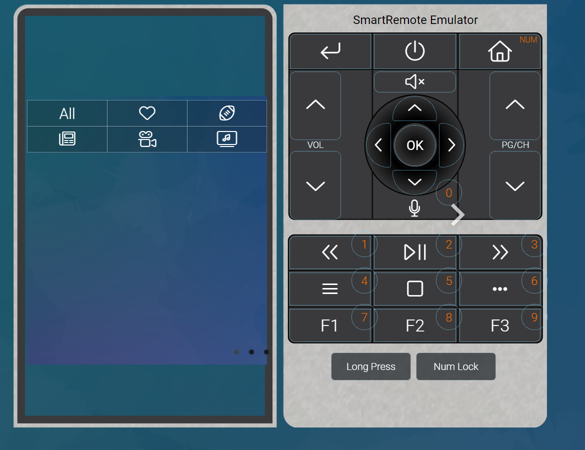

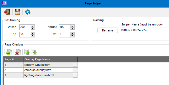

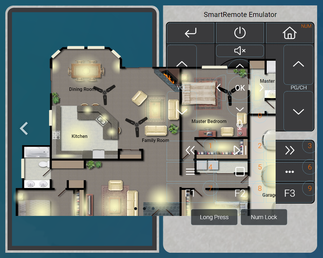

Just for fun, I created a new scene and put the page swiper control on the page.  I then configured it with 3 existing overlay pages and added a button on the main index page to load the scene.  I launched the emulator and the control seems to work as it should.  I can use the mouse to swipe left/right and I see the dots indicating how many pages there are.  Note that I did not configure these overlays in my test scene on the Overlays tab.  Here are a few screen shots.
