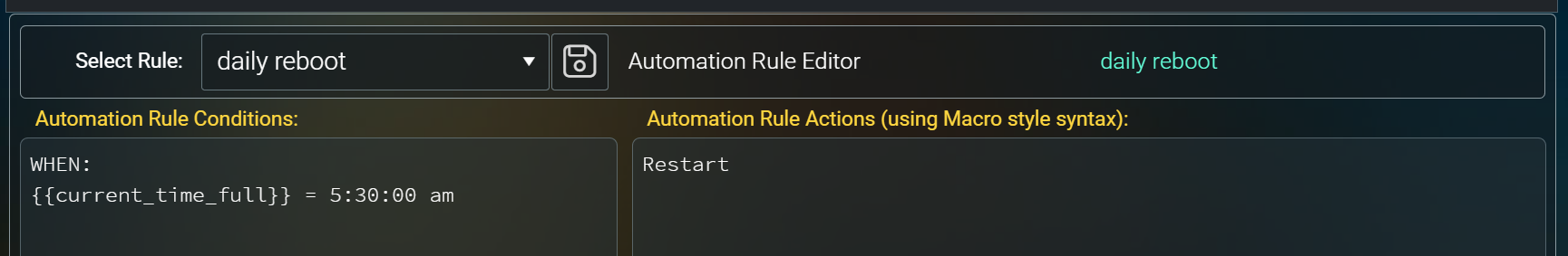

Thanks, this is all very much appreciated.  Screenshot attached for the automation - is this syntax correct?

Did you try to set the trigger for 1 minute from now and let it run to see if it works, then if so, reset to the time you want. I don't have syntax memorized like DaveP does :)

My syntax above was correct (I set it for one minute later and the server did indeed reboot). Thanks for that.
