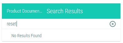

I am going to try to sell my Smartremote setup. I would like to reset everything before doing so. I can't find any documentation on it. How do I do it?
