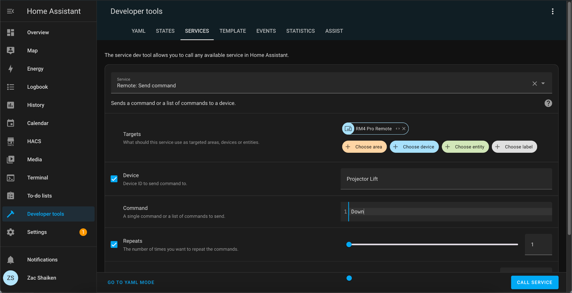

Ok I have this added, however now I could use some help actually using it. This is currently listed as a Control device. In HomeAssistant, using Developer Tools, I am sending this:
Is there a way to make myServer send this?

Here is the HomeAssistant YAML if that helps:
service: remote.send_command
target:
device_id:
- 1bce0eab1bab833c89e0cfc52cbdfd39
data:
num_repeats: 1
delay_secs: 0.4
hold_secs: 0
command: Down
device: Projector Lift
I also have these added to a HomeAssistant script, so I will test and see if there's a way I can just call that instead. Update: Not seeing a way to trigger Home Assistant scripts either
