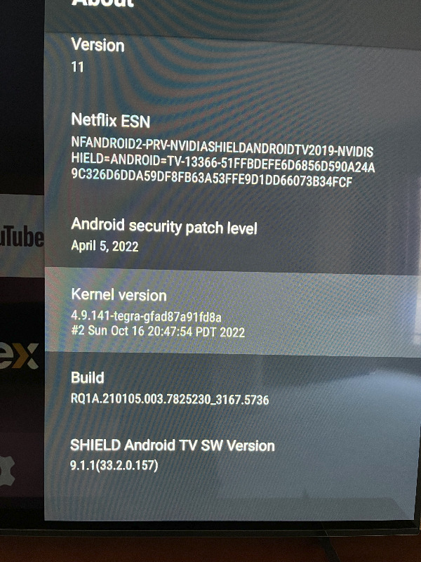

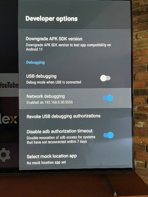

#619
Screenshots showing versions and ADB settings are attached.

Re: NVIDIA Shield Pro 2019
#622
The Shield should show a prompt to choose to allow myServer connection. This has not been apparently not been approved yet.
AndroidTV driver will flush the ADB connection and the driver will auto attempt to connect again. You should then see the prompt again on the TV connected to the Shield to approve with the Shield's handheld remote control.

You can test with ADB commands in a Terminal Window from the myServer 6 Pi.
like:
ADB Devices (will show you currently connected devices)
If you look in the AndroidTV driver documentation...lots of other commands / syntax and usages.
Do a NMAP on the Shields IP address to see what ports are open.  Classicaly 5555 is used.
