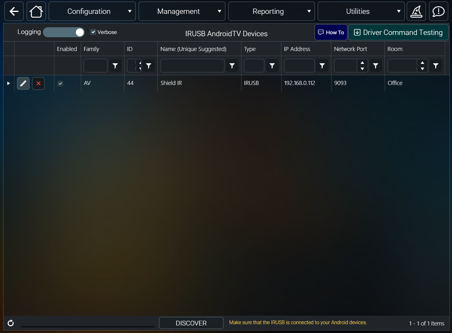

Then use discovery or manually add your IRUSB device in the driver.

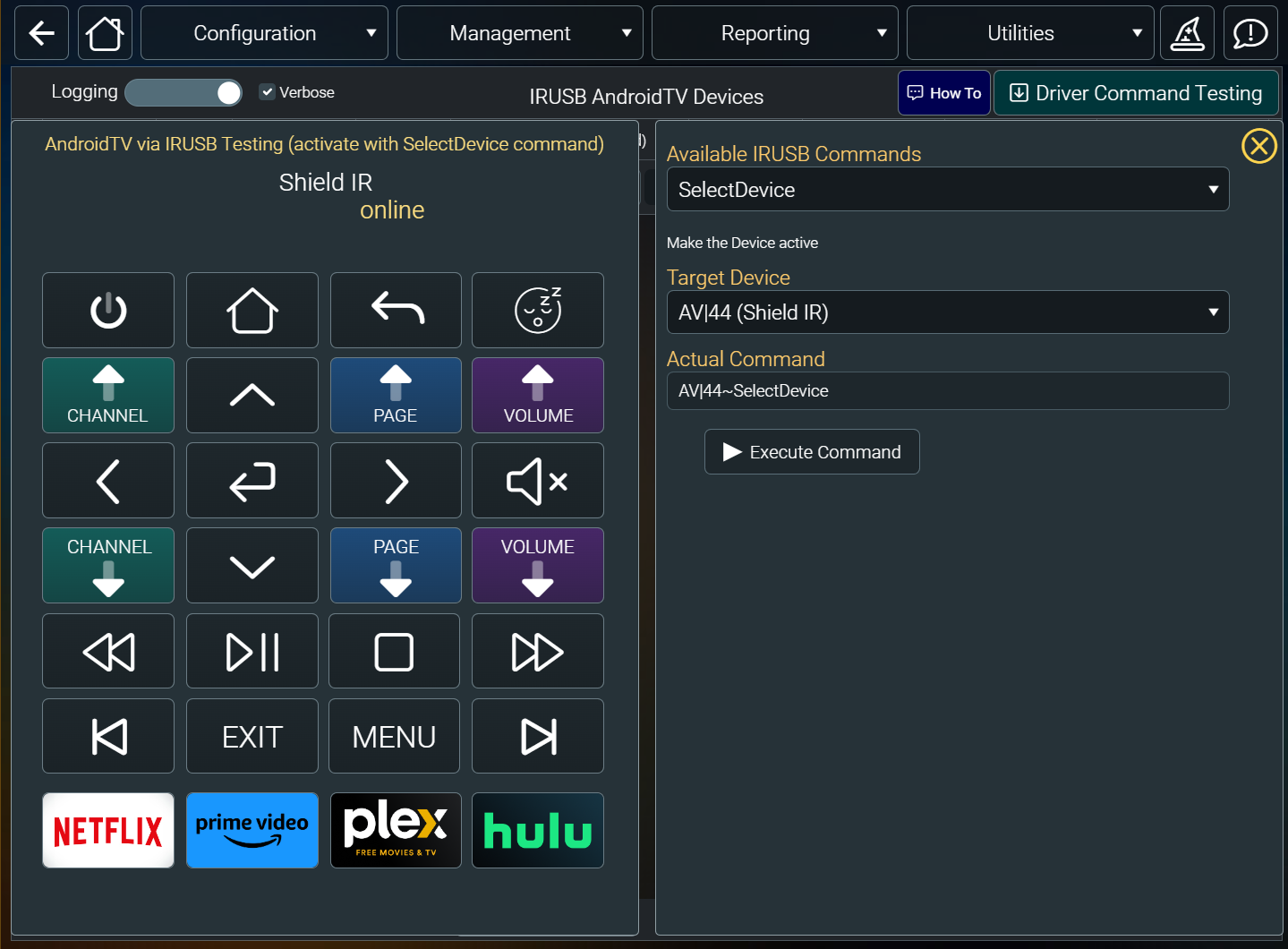

Use the command builder to exercise the available functions.

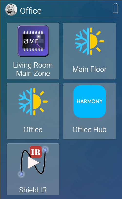

The Smart Remote sample template incudes a sample page for the IRUSB. It will show up like this on the index page

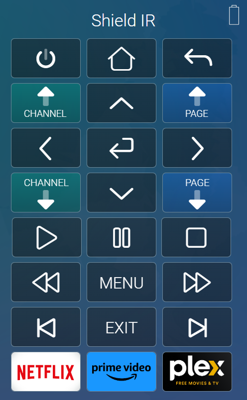

While the irusb.html page looks like this.
Uses the tvcontrol.html as the standard UI for the IRUSB usage.
