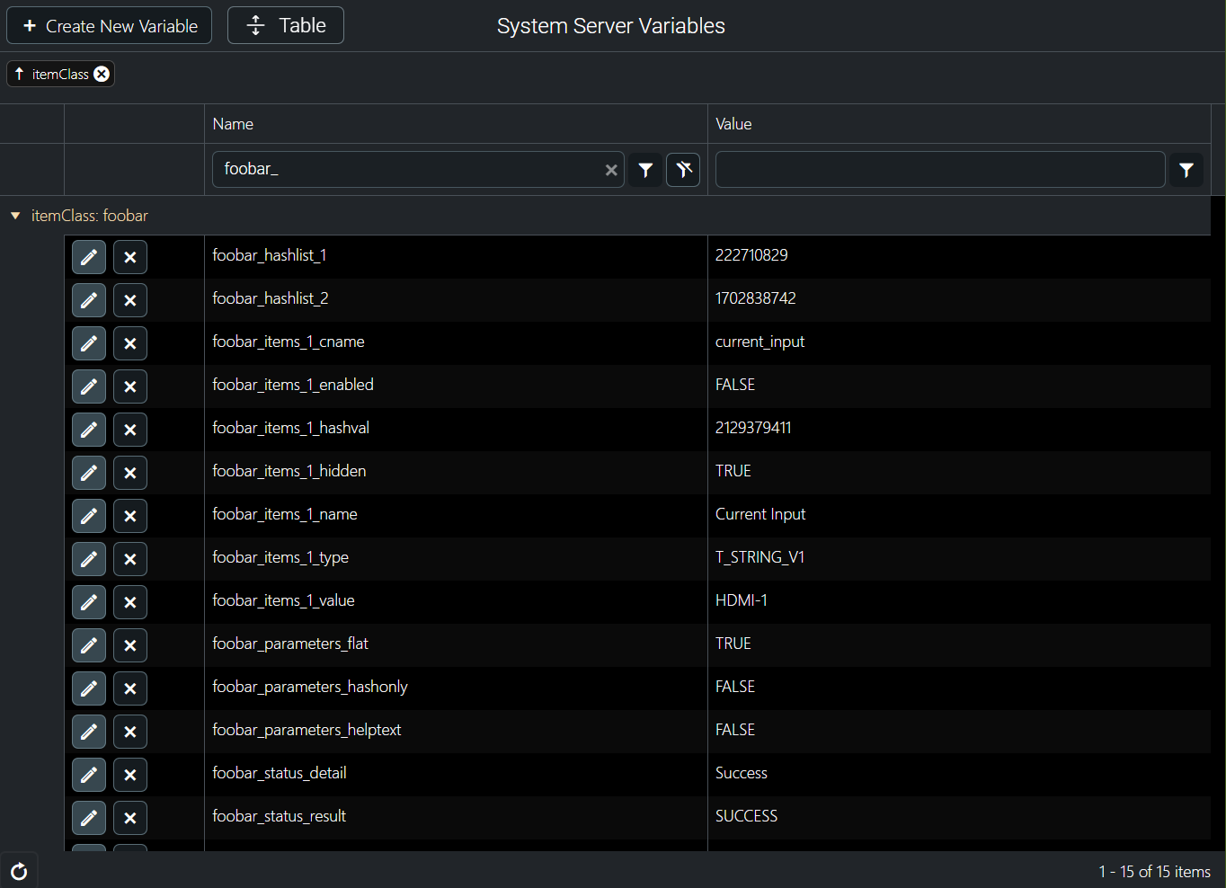

Running Curl commands
1) Modifies the Run command to add an additional third parameter that will receive the output of the command for further processing.
        Run|Program~Parameters~resultsVariable
2) Adds a new command called RunParseResults
        RunParseResults|Program~Parameters~ResultsVariable
We tested RunParseResults using your previous json response as its output using RunParseResults|curl~params~foobar  and this is what server variables were created. Probably a bit overkill but perhaps useful.
