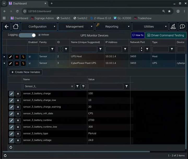

Step 5: From the UPS Monitor / Command Builder run the Add Host command.
For example; UPSMonitor|AddHost~UPS Host~10.10.1.4~3493~Unknown
Change 10.10.1.4 to yout myServer IP address.
Close the command builder and after a few seconds you should see your UPS show up as a new device in the grid.
 You should see something like the following:
UPSMonitor 1

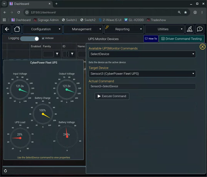

 Then if you go back into the command builder and run the SelectDevice command on the new UPS you should see this.
UPSMonitor 2
 If the gauges are working you're done.
