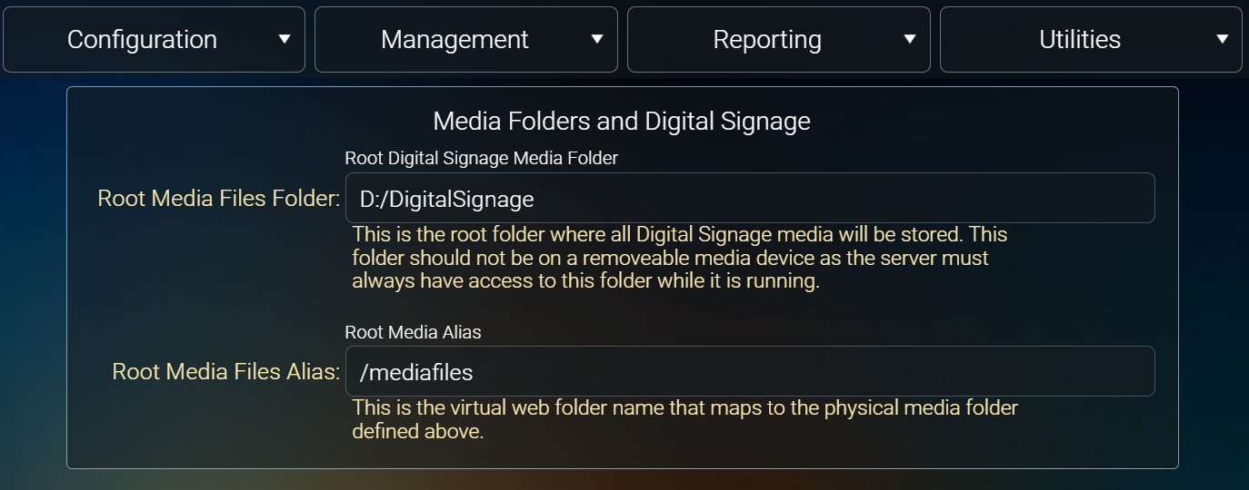

In Dashboard under Configuration / Media Folder change Root Media Files Folder to a valid folder. Or set it back to its default value /home/allonis/applications/myServer/wwwroot/media
