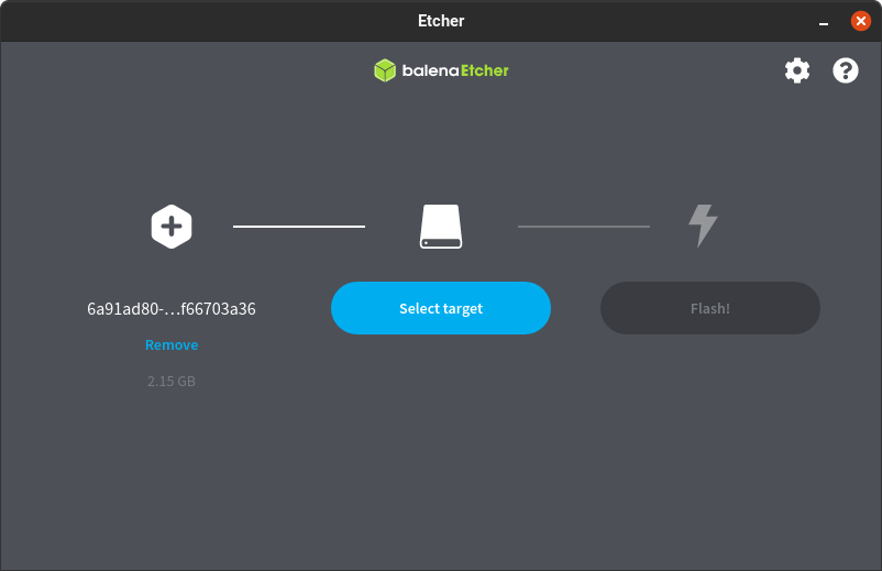

2) Once download has finished, you’ll have a zip file.  Unzip it.  Put the file on same PC that Etcher is running.
Screenshot of the Etcher software showing the select target button highlighted.

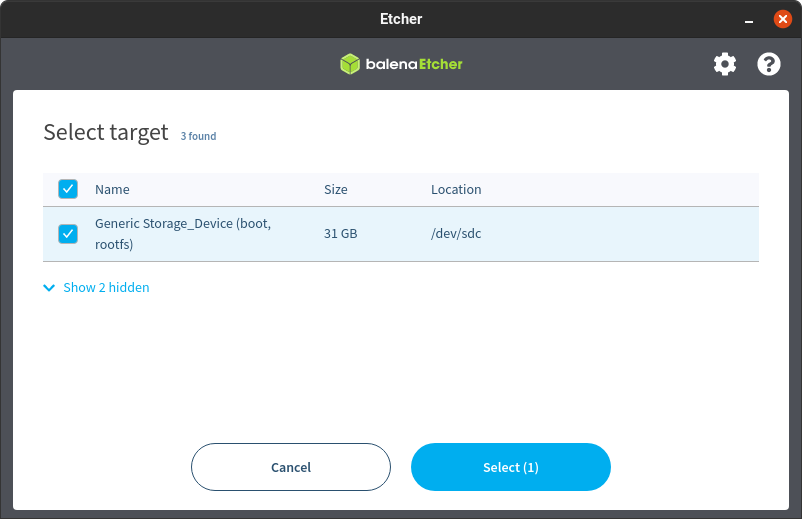

Select the USB Flash drive you want to use for your Raspberry Pi (NOT the Boot Drive! - which is typically hidden from view) and NOT the "Old" corrupt USB (burn to a new USB drive).
Screenshot of the Etcher software showing teh targets available.

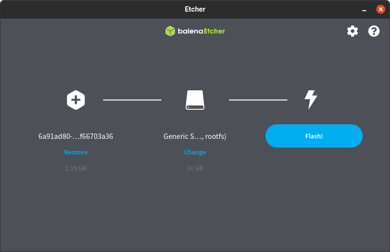

Click on “Flash!” to start writing the image:
Screenshot of the Etcher software showing the Flash button highlighted.
When Balena Etcher is finished writing and validating the image you will get this confirmation:
Screenshot of the Etcher software showing that the installation has completed.
