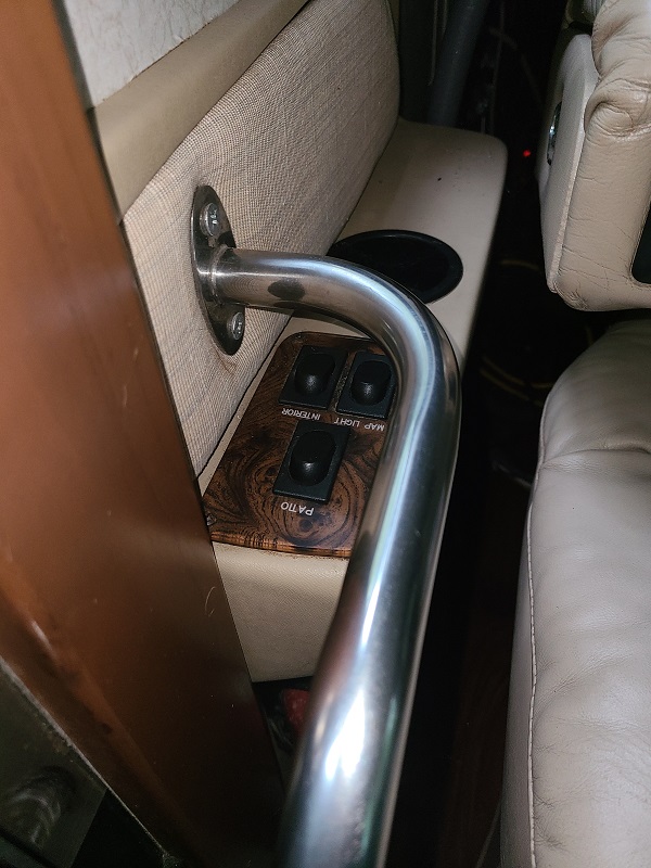

Shelly makes some very small Wifi relays that work on 12 volts.  This makes it perfect for usage in RVs / Boats / Trucks / Autos.
This is the original switch layout.  For overhead lights, Map lights, Patio.

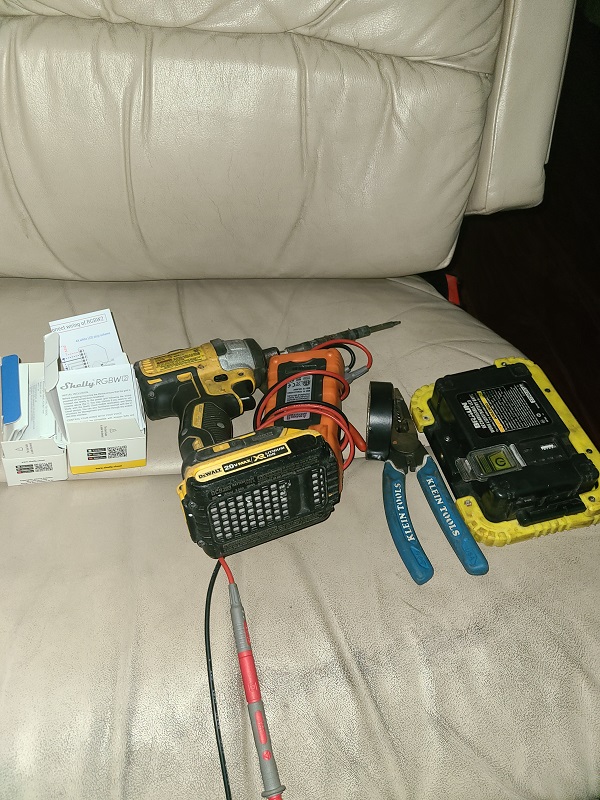

Typical wiring tools needed.  Important is a multimeter.
Tools1

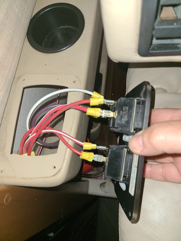

Here is the original wiring.  Each Switch is fed Power.  Then the Load (the lights) are on the other side of the switch.  There is no Ground cable here.
OriginalWiring1

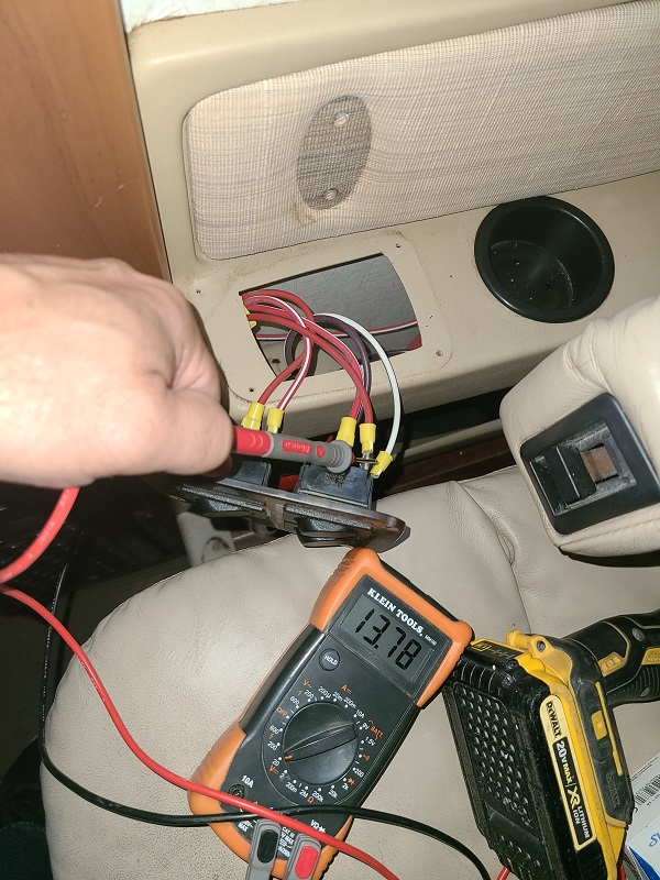

Check with the multimeter which switch connector has constant power.  Check for power with the light switch off.
CheckForPower1

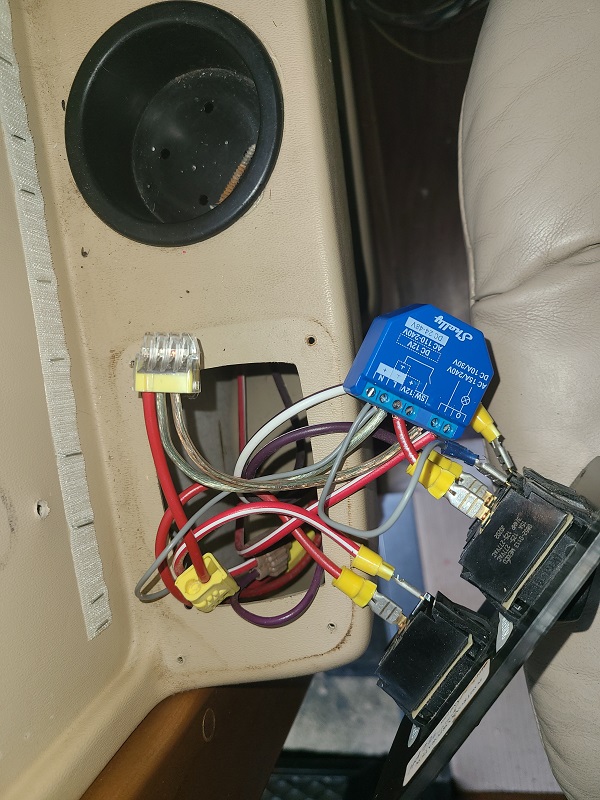

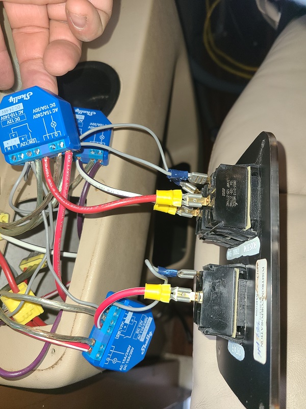

Splice in the new Shelly relay.
The old power wire goes to a Wago 3 or 4 position connector.  Then run a shorter 12 gauge wire to the Shelly 12V+
I added a new ground wire that is connected to the window frame screw above the switch assy.  This can be a smaller gauge wire as no large current will flow to it.
Wire the old switch to the Shelly Switch connection.  Run the Ground to the other side of the switch
Run the large positive wire from the Wago connector to the Input of the relay
Run the large Load wire to the Output of the relay.
Relay1
Repeat with the other two relays
Relay3
Test that all works using the Shelly app

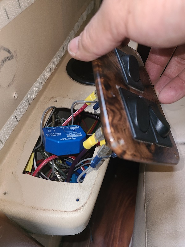

Double check there are no wire hairs to short on anything.  Then stuff the relays into the enclosure and screw it all together again.
CloseItUp1
Clean up everything and put it all back together!  You should now be able to use either the mechanical old switches, or connect myServer control system to control the switches according to time, occupancy, or remotely.
