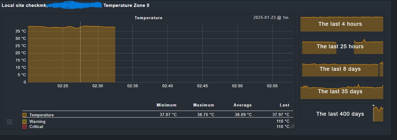

Mine's in the official rackmount case and is usually at about 39 - 40 ℃. I've setup a whole checkmk monitoring installation just to try to get to the bottom of this and the temperature graph doesn't show any kind of spike before everything dies.

andrew's Avatar Topic Author
Re: Rackmount myServer - whole server unresponsive
1 year 9 months ago
#3865
