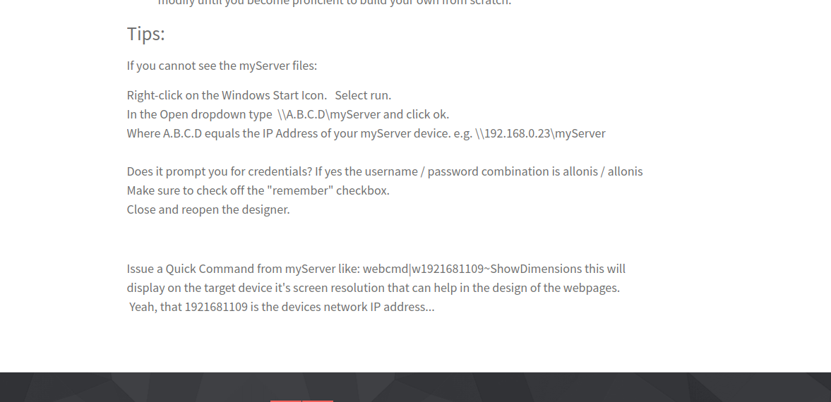

Yeah, sorry, I should have mentioned all the things I've tried. They include (reluctantly) enabling SMB1 CIFS client on the Windows PCs. No go. Thanks anyway for the suggestion.

What does it say when you do this ?
Ah, that was what I was remembering. It's in the docs isn't it? But I couldn't find it. Mind you it was 2am so I was a bit bleary-eyed by then. Anyway I'm afraid that has the same effect as typing the share into the File Explorer path bar - absolutely nothing happens (except the run dialog disappears in this case).
