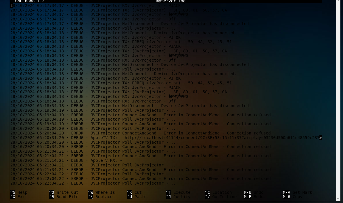

Snippet from log this morning when it went down.

I can't remember if this has been asked before but do you have other tools that might be connecting to the JVC as well? Things like HomeAssistant or other remote control apps that might grab the connection so that MyServer can't connect.

None that would be trying to connect via the web port.
Harmony runs it through ir, I don't have home assistant connected to it and my windows VM with the JVC app hasn't been active in over 6 months.
Is it possible it's a faulty network cable or port on the JVC ? I have difficult time believing but willing to explore options at this point.
