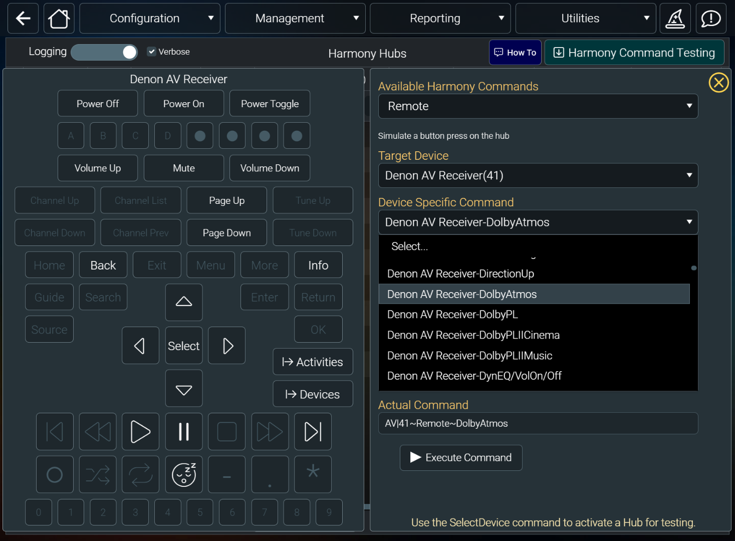

Dave - quick question - how do I see the commands that are not listed on the soft buttons (for eg my Denon, Harmony has a long list of commands - eg to turn Dolby on or of etc) - which used to be in a long list with the previous driver?
2 years 6 months ago
#2285
Go back into Dashboard Harmony command testing.
Select the Remote command. Then select the target device. e.g. the Denon.
Then the Device Specific Command dropdown will show all the available Denon commands
Use the Actual command on the server command on a button on your custom scene.
