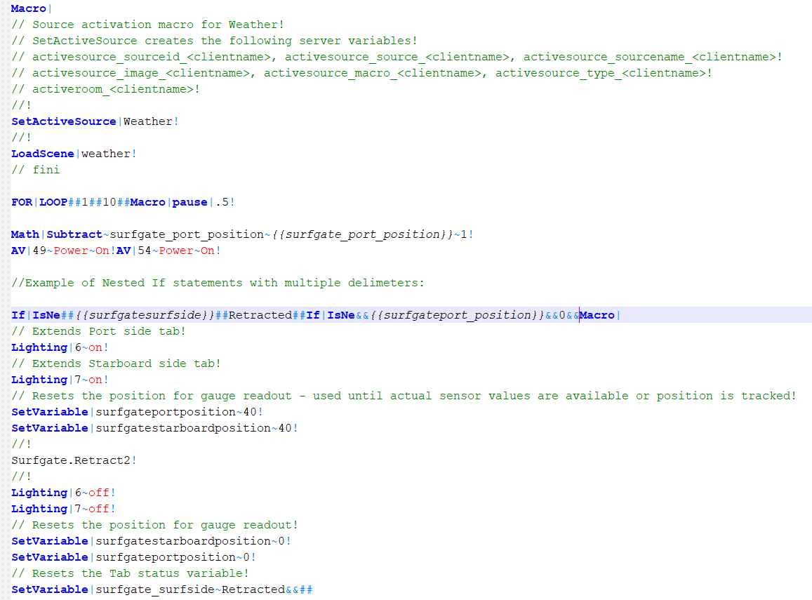

I've made a start but I'm not an expert at defining NP++ UDLs and I don't know if the system will be able to cope with myServer macros unusual structure.
File Attachment:
File Name: userDefineLang.zip
File Size:902 B
The .xml file goes in C:\Users\[username]\AppData\Roaming\Notepad++
Thanks seems to be a good start a few things not working like if you have
AV|49~Power~On!AV|54~Power~On!
it only highlights the first command in the line
I started looking at doing this myself but like you not an expert with udl's  and still struggling with myserver commands
was hoping one of the Dave's would be familiar with this and it seems like they can write this code in there sleep.
On a side note I'm starting to like the syntax of the commands
Thanks

Here's a better one. It's not going to syntax check for you but it makes things a bit more readable.

I'm out at the moment but looks awesome!
Re: Language
#1155
I see you found my WakeSurf boat control code!
Good to see it repurposed.
Hope it helps.
